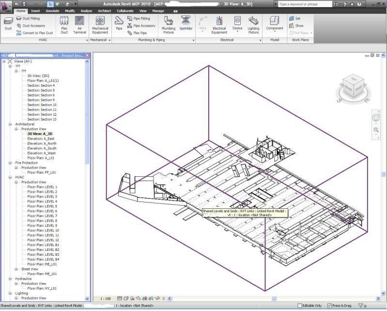

OK I'm in the learning process of revit and have come across something very frustrating. I can't work out how to turn it off. I have a building model here, and am trying to put stuff in it, but whenever I try to snap to something it snaps to a wireframe invisible box (that turns visible) around the whole building. Does anyone know how to turn this box off? If you don't know what I'm talking about I can post up a screenshot if that helps.

that purple cube is only visible when i'm trying to snap onto stuff. if i wobble the mouse around enough it will snap on to something but it's to time consuming. hopefully there is a solution.

It seems as if you are trying to reference a linked model. That is why there is a purple bounding box. Furthermore, you would do better to draw in a plan, elevation or section view as 3d views in Revit are not geared towards drawing in (at least in my experience).

Yep it is linked. I was just trying to quickly turn on and off elements to see bits in 3d angles that have been done wrong for the area I needed to look at in conjunction with my stuff. It wouldn't let me select elements easily instead it was intent on me selecting the box.

You can turn elements of a linked file off through the Visibility Graphics dialogue. Go to the Imported Categories tab and you will find a list of files imported. If you expand the + symbol you will notice you can turn off elements from the linked files.
