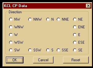

David Bethel Posted October 12, 2009 Posted October 12, 2009 Greetings, Has anyone ever made a DCL similar to DDVPOINT X Axis inputs? I'm trying to select only the 16 compass points ( 22.5 degree ). The DCL radio button screen is really bad. The graphics view would be much better. I've started to break down DDVPOINT.lsp but I've never used the image tile before. -David DDDIRSLD.ZIP Quote

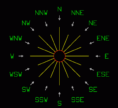

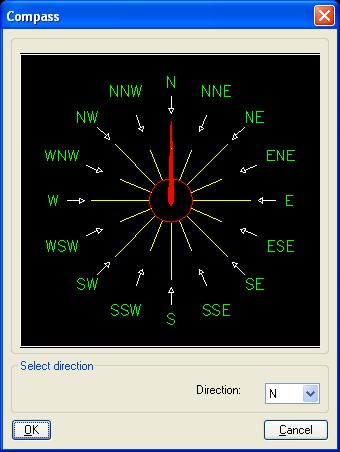

The Buzzard Posted October 12, 2009 Posted October 12, 2009 Thanks for the replies. I'll try the tutorial as seems to have the basics. -David David, Give the program below a try. I redrew your slide and placed it in its own dcl. If this is what you are looking for, I will be glad to give you all the specifics. This was created with the mimage2.lsp I posted. External slides are not required because they are built-in to the code. The mimage2.lsp will write the lisp code for the image as well as the dcl code for you. There are some additional steps that need to be taken, But I can get you thru all that. Note: The more complex the image the larger the code will be. If you need an image button to work exactly as the DDVPOINT.lsp, Then proceed with the tutorial. Just let me know. COMPASS.zip Quote

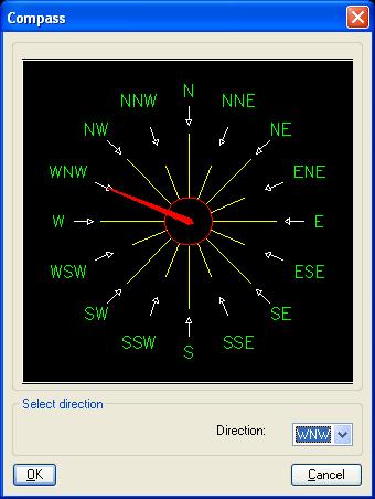

The Buzzard Posted October 13, 2009 Posted October 13, 2009 Buzzard, Thanks! I didn't know that images could be generated via the lsp routine. I was looking more to the ddvpoint input of pointing to direction in image tile and it returning the direction angle or compass value. Your's will be a good learning for me. Thanks again! -David I glad you like it. Technically the image is a Windows Metafile. I am sure you could make something like this work for you in your program. Just to mention the mimage2.lsp was created by Viper from the Exchange Forum. I have been using this program for all my slides and never went back to making external slides again. It works sort of the same manner a script would with exception that you need to control the movement of the pointer thru the popup list. The image you provided was redrawn and made into a slide with the program and used as a background image. I created a pointer and made an image for each movement (22.5 degrees) and placed it in a conditional to operate with the popup list. Care needs to be taken so that there is no shifting in the view that you create all this. I make a saved view just in case of any accidental shifting. This ensures clean movement of the pointer. When running the mimage2.lsp it will create two files. vimage.dcl & vimage.lsp and place them in a TEMP directory on C: drive. I just remove the lists and place them in my program. You would need to experiment with the frame size to get the size slide you want. The above compass slide used a dimx_tile value 300 x dimy_tile 295. I used a black background for the compass and no background for the pointer. If you decide not to use any background color and want to us the dialogs gray background, You will need to make sure your slide is made with darker colors to stand out. This is the same method that is used for most of acads images that are in dialogs. Example: The dimension style manager which changes when you select different options and the ddvpoint dialog also. Take note that the text used in those dialogs are standard fonts. The reason for this is to keep the lists smaller. When ever you use a font with more curve or use any circles you can expect the lists to be large. I also want to point out that solids do not work well as the fill becomes sort of empty. In this case I used a hatch pattern for the pointer to give it that filled look. Just think about it, When you compile your program to vlx, The slides are now included. Real Neat! I hope this gives you an idea what its all about. I will be happy to answer any questions you have about it. Good Luck, The Buzzard Quote

The Buzzard Posted October 14, 2009 Posted October 14, 2009 I think that the big difference is that DDVPOINT uses a static the background slide image and then adds the white direction vector line. It doesn't seem to redraw the entire image with every click. That seems to make sense to me. I just haven't figured out how they do it yet. -David Thats how I did it in the COMPASS.lsp, But because this is an Image Button and your image always stays the same with exception to the indicator, It could be set the same way as mine. The function call would only need to provide the indicator going in its proper direction. My Compass.lsp uses a conditional because I am operating it with a popup list and this would not be useful in this situation. The function call is the way to go. The following code provides the coordinates for the image to change in five directions. You would need to change this to calculate 16 points along a circumference. When the cursor is placed on a coordinate and clicked it would trigger to go to its respected function showing the pointer image to match. So you would need 16 pointer functions in addition to this. ;------------------------------------------------------------------------------- ; c:My2 ; These images were created using GetVectors.lsp on AutoLISP Exchange ; (URL: [url]http://web2.airmail.net/terrycad[/url]) ;------------------------------------------------------------------------------- (defun c:My2 (/ Dcl_Id% Show_Image:) (princ "\nMyImageButton")(princ) ; Show_Image: ---------------------------------------------------------------- (defun Show_Image: (/ Ang CenPt Dist~ PickPt X# Y#) (start_image "Image1") (setq X# (dimx_tile "Image1")) (setq Y# (dimy_tile "Image1")) (end_image) (setq CenPt (list (/ X# 2)(/ Y# 2)) PickPt (list $x $y) Ang (angle CenPt PickPt) Dist~ (distance CenPt PickPt) ) ;setq (cond ((< Dist~ (/ Y# 4)) (Front_View)) ;*Included ((< Ang (* pi 0.25))(Right_View)) ;*Included ((< Ang (* pi 0.75))(Bottom_View));*Included ((< Ang (* pi 1.25))(Left_View)) ;*Included ((< Ang (* pi 1.75))(Top_View)) ;*Included (t (Right_View)) ) ;cond ) ;defun Show_Image: ;----------------------------------------------------------------------------- ; Load Dialog (setq Dcl_Id% (load_dialog "My2.dcl")) (new_dialog "MyImageButton" Dcl_Id%) ; Set Dialog Initial Settings (set_tile "Title" " My Image Button") (set_tile "Text1" "Pick arrows to change views.") (Front_View);*Included ; Dialog Actions (action_tile "Image1" "(Show_Image:)") (start_dialog) ; Unload Dialog (unload_dialog Dcl_Id%) (princ) );defun c:MyImageButton ;------------------------------------------------------------------------------- Quote
