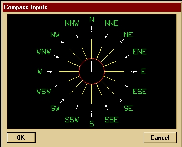

David Bethel Posted October 15, 2009 Author Posted October 15, 2009 Tim, That's what I understood. I'm having problems getting the center of the image to align with the center of the image_button. It must have to do with the width / height attributes in the dcl image_button call. -David Quote
David Bethel Posted October 15, 2009 Author Posted October 15, 2009 Another thing that I don't understand. It looks like dimx_tile returns pixels. What type of value does the image_button width attribute look for? -David Quote
TimSpangler Posted October 15, 2009 Posted October 15, 2009 If i am not mistaken the values of the image_button are system dependent. I remember reading something about using a ratio for image button when creating vector images. Anyway when I changed your code to this: dcl_settings : default_dcl_settings { audit_level = 0; } comp : dialog { label = "Compass Inputs"; : row { : image_button { key = "Image1"; alignment = centered; width = 50 ; aspect_ratio = 0.98; color = -2; } } : row { ok_button ; cancel_button ; } } it seems to work fine. It looks as thought your vector image is over drawing your image button. I just keep playing with the size attribute in the dcl until it looks right. I'll try to find the ratio code for vector graphics and post it here. Quote

The Buzzard Posted October 15, 2009 Posted October 15, 2009 Tim, That's what I understood. I'm having problems getting the center of the image to align with the center of the image_button. It must have to do with the width / height attributes in the dcl image_button call. -David David, Here is the button used in Terry's dcl with the new figures for the image I made. : image_button { key = "Image1"; width = 49.92; height = 22.66; fixed_width = true; fixed_height = true; aspect_ratio = 1; color = -2; } This will center your image in the tile. When I created the vector image for the Compass.lsp I used 300 for the dimx by 295 for the dimy. If you want to make the tile smaller another image would need to be created. Quote

The Buzzard Posted October 15, 2009 Posted October 15, 2009 Ok, Got some of it figured out: $x & $y are returned automaticallyYou cannot overlay vector imagesYou must include the direction vector in the new image What I haven't figured out: How the size of image is calculatedHow to align the center of image_button and the center of the imageWhy is every thing 180 degrees out ( I used (- (* pi 2) ... -David David, I just caught this post. The part about not being able to overlay another image is not completely true. I just want to clarify. On the Compass lisp I use one static image of the compass and overlay the pointer showing movement with a conditional. When creating the pointer with the mimage2.lsp no background is selected so all you are imaging is only the pointer and nothing else. I hope I am not misinterpreting you. If you open the Compass lisp and go to the COM_UFI function you will see where I start the image. The end image is at the end of the conditional or at the end of the function. If you think about it, Thats 2 images in 1 start to end image call. On the other hand, Since an image button is being used in this case, The idea about one static image being used here may not seem possible. You may have to repeat the compass image with it pointer going in the right direction for each 16 positions. In this case you may have no choice but to have redundant images to complete this task since with each selection a frame change is required. Quote
David Bethel Posted October 15, 2009 Author Posted October 15, 2009 Buzzard, I thought that you redefined "iMG" each time the input changed. What I was referring to is that I have not found a way the display the background and then overlay another entire image ( the direction line ) over the background. I think the complete image must be defined and then displayed each time. I foresaw this as a tough one and it has turned into a even more complicated project than I anticipated. I'll keep plugging at it. Thanks for all of your help! -David PS I have the Y axis dead on. X is still off Quote

David Bethel Posted October 15, 2009 Author Posted October 15, 2009 Getting closer: Add 1 pixel on the x axis for the dimx_tile callAdd 1 pixel on the x axis for the rounding down ACAD doesFound the exact aspect ratio of the screen when the slide was madeIncrease the inner circle diameterDecreased the direction vector length(this way your eyes can't compare the direction vector and compass lines to the nth degree) -David COMP4.ZIP Quote
The Buzzard Posted October 15, 2009 Posted October 15, 2009 Getting closer: Add 1 pixel on the x axis for the dimx_tile callAdd 1 pixel on the x axis for the rounding down ACAD doesFound the exact aspect ratio of the screen when the slide was madeIncrease the inner circle diameterDecreased the direction vector length(this way your eyes can't compare the direction vector and compass lines to the nth degree) -David David, Just out of curiosity, Are you using the mimage2.lsp? And if so, Are you running into any problems that I can help you with there? Quote
The Buzzard Posted October 15, 2009 Posted October 15, 2009 Thats great David, It operates smooth. And I see you are using a conventional slide for this. So that answers my question. Great work! Quote
