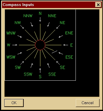

The Buzzard Posted October 16, 2009 Posted October 16, 2009 Buzzard, COMP6.DCL wasn't included in the zip. The last atom of the vector_image list changes the color. Look like the only time ACAD uses vector_images is to either draw a box around a tile and the point in DDVPOINT. I don't think that they imagined it to draw entire images. Not that it can't, just wasn't the initial concept. Too bad mimage doesn't do the line breaks. -David Sorry about that, I grabbed the wrong file. Try this one, Make sure you use both file in this zip since I made a few changes to the lisp. I still have a problem with some image distortion. When I run the file created in VIMAGE that was created by MIMAGE2 the distortion does not show. There is something in the COMP6 program that vector image does not like. COMP6.zip Vimage.zip Quote

The Buzzard Posted October 16, 2009 Posted October 16, 2009 I did a bit more with the image to improve the distortion. I ended up with one small red speck near the top left. I am out of answers on this, But its an improvement. COMP6.zip Quote

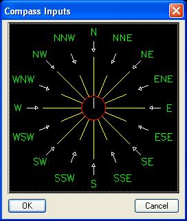

The Buzzard Posted October 16, 2009 Posted October 16, 2009 I never went thru this before, But for some reason when formatting the list seems to give the image that distorted look. The attached lsp & dcl have the list unformatted and the image looks good. I went thru alot of other changes without solving anything. I also found out that VIEWRES has an affect on the program list size as well. This is the best I got the image so far. COMP6.zip Quote
David Bethel Posted October 16, 2009 Author Posted October 16, 2009 Some thing weird is happening. Just as you posted in Release 2000 on main cad machine, it doesn't look like your image. ??? On my rendering machine, it comes out close. Again in Release 2000. -David Quote
The Buzzard Posted October 16, 2009 Posted October 16, 2009 Some thing weird is happening. Just as you posted in Release 2000 on main cad machine, it doesn't look like your image. ??? On my rendering machine, it comes out close. Again in Release 2000. -David My dcl settings for that image is: dimx_tile = 250 dimy_tile = 250 : image_button { key = "Image1"; alignment = centered; width = 41.59; fixed_width = true; height = 19.20; fixed_height = true; color = -2; } I could make it any size needed. As I said before you need to try different settings to suit your taste. Quote

David Bethel Posted October 17, 2009 Author Posted October 17, 2009 Buzzard, I checked the image_x and image_y values on 5 machines and 5 releases. They are definitely machine / release dependent. For your comp6 I got: x y 250 250 291 250 333 307 374 307 My slide_image version varied just as much: x y 300 204 350 238 400 272 450 306 1 @ 800 x 600 4 @ 1024 x 768 The 800 x 600 displayed correctly on R14 and 2000. Overall about 20% displayed comp6 wrong. Maybe some guru will step up and explain it to us. I'm curious now. -David Quote
The Buzzard Posted October 17, 2009 Posted October 17, 2009 Buzzard, I checked the image_x and image_y values on 5 machines and 5 releases. They are definitely machine / release dependent. For your comp6 I got: x y 250 250 291 250 333 307 374 307 My slide_image version varied just as much: x y 300 204 350 238 400 272 450 306 1 @ 800 x 600 4 @ 1024 x 768 The 800 x 600 displayed correctly on R14 and 2000. Overall about 20% displayed comp6 wrong. Maybe some guru will step up and explain it to us. I'm curious now. -David I would think it would have to do the Monitor size as well as the graphics card settings. I am not so sure about the release. Anyway how are you doing with the program? Any progress? Quote
The Buzzard Posted October 17, 2009 Posted October 17, 2009 I know what is going on now. I have been editing the same program over & over using different setting and aspect ratio. Somewhere on your system in the acad search path you have an older copy of COMP6.dcl. You may be openning a specific program, But its loading one of these older dcl's. I have seen this happen before. I should have renamed the program differently. Please disgard any of these older programs and dcl's. I have been trying to fix the color distortion and found that if I place the vector image lists in the program and do not do a manual format the image appears good. You also may have noticed I have been reducing the image size as well. This is why you are seeing a smaller image inside of a larger dcl. Here is a copy renamed to COMP10.dcl & COMP10.lsp. Just type COMP10 to start. You should see it in its correct size now. I assume you do not have any copies named COMP10. COMP10.zip Quote
David Bethel Posted October 17, 2009 Author Posted October 17, 2009 Buzzard, I have the main parts done now. The end result is a mechanical connection point with a descriptive letter ATTRIBute that is located in a preset distance from the center in the direction specified buy our compass input and a hidden mechanical data ATTRIBute. Thanks! -David COMP8.ZIP Quote
The Buzzard Posted October 17, 2009 Posted October 17, 2009 Buzzard, I have the main parts done now. The end result is a mechanical connection point with a descriptive letter ATTRIBute that is located in a preset distance from the center in the direction specified buy our compass input and a hidden mechanical data ATTRIBute. Thanks! -David The alignment of the slide seems to appear to the left side of the dcl. I have checked and seen you have center alignment. You should check that out. Not sure whats going on there. Quote
David Bethel Posted October 17, 2009 Author Posted October 17, 2009 Buzzard, I've been playing with alignment attribute with little success. I assume you do not have any copies named COMP10. I try to use an incremental renaming scheme on a program or project for that reason. COMP10 was worse the than 6 on the machines I tried it on. Go figure..... -David Quote
