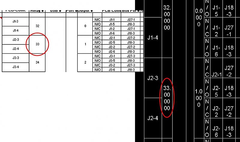

I have a spreadsheet that I copied and did a paste special AutoCAD Entities. So far I've done several of these tables this way and haven't had a problem until now. When I paste the spreadsheet some of the cells get 0s added. When I double click on the cell to remove the 0s, the 0s disappear. When I click elsewhere and the cell returns and the 0s also return. The 0s are not in the spreadsheet but were some how added when I pasted.
Any ideas on how to get rid of the extra 0s?
I've attached a JPG to show what I'm talking about.

Got it figured out. I had changed the cell format from General to Text but it didn't seem to do anything. After posting here I decided to change it to Number and make the number of decimal places 0 and that worked. Go figure!
