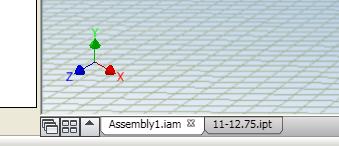

Is there a way to get AutoCAD to view the tabs at the bottom of the screen like Inventor does for other drawings you have open?
I have inclosed a snap shot of what I am looking for.

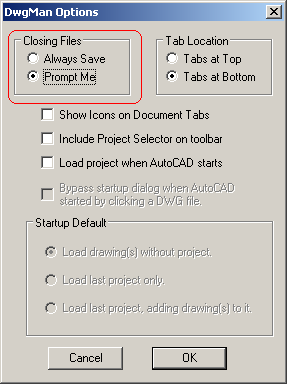

I like DWGMan, simple and effective.
http://www.caelink.com/drawing_tabs.htm
Thanks that worked great.
No problem. :)
Be sure to check the options, especially since, for some strange reason, it defaults to autosave if you close a drawing with it.
