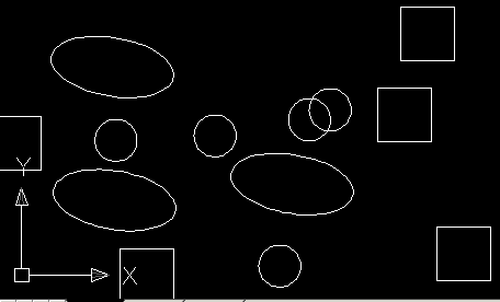

This is a first draft, so it's crude and needs testing (I don't have many Dynamic Blocks at home). However, at the moment, it will allow the user to select a Dynamic block with visibility states and change the visibility state of either, all or a selection of each occurrence of the specified Dynamic block.
Call with: VC
As always, any feedback, etc. is welcome.

I wasn't sure if this was even useful. It doesn't benefit me, so I'll happily abandon it. :)

but it didn't work at all, didn't got even a error back :(
Edit I blame me for not filling in the correct parameter, autocad made visibility1 instead of just visibility. It now works!
