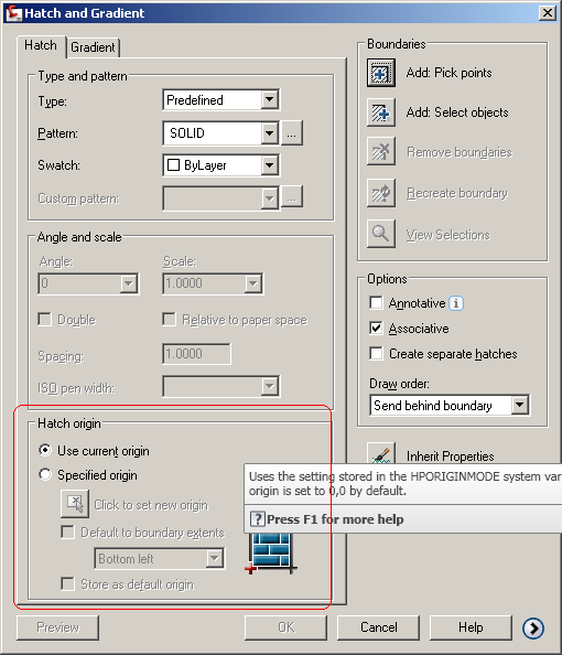

alanjt Posted October 16, 2009 Posted October 16, 2009 I am using Autodesk Land Desktop 2004. The only hatch I have problems with is Gravel. Half the time I try to use this Hatch it becomes scrambled. Pick a new origin point. Once you've fixed one, you can match properties to fix the rest. Quote
eml-g Posted October 16, 2009 Author Posted October 16, 2009 My Hatch Dialog box doesn't look like that. I don't know how to redefine the origin of the hatch. Quote
alanjt Posted October 16, 2009 Posted October 16, 2009 My Hatch Dialog box doesn't look like that. I don't know how to redefine the origin of the hatch. Hmm, it's been a while since I've dealt with 04, can you post screen shot of your hatch? You can also set it by hporiginmode. Quote

eldon Posted October 16, 2009 Posted October 16, 2009 I think that you will find that the system variable HPORIGIN came in with AutoCAD 2006. So you will have to do it the old fashioned way, and create a UCS near the area to be hatched. I seem to remember several posts that complained that the GRAVEL hatch scrambled itself, and it turned out that the coordinates were a long way from the origin Quote

dtkell Posted October 16, 2009 Posted October 16, 2009 I believe the "SNAPBASE" command will allow you to set your hatch origin point for this version. Pick a point near the object you are trying to hatch. Then "HATCHEDIT" your hatch. Preview it and it should appear the way you want. Quote
