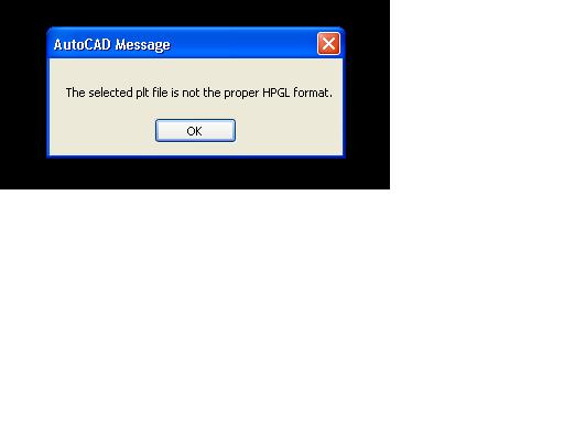

I have many PLT files I tray to convert it by using express -> file tools -> convert PLT to DWG but it me this message ( see the attached)
that would imply that the plot file wasn't generated with an HPGL plotter driver. Not a lot to suggest. You could try sending the file to a plotter and scan the result, or get new plt files.
I suspect the .plt files were created using an unsupported driver
