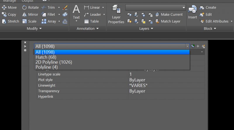

The problem with exploded text, is the large file size though. I need my STAMP to stay with specific font. Hence, I exploded it and used solid hatch to re-create it. A simple one word stamp is now ridiculously 800KB! I have used purge, audit, wblock, you name it ! but the file size is still big.
Any idea how I can reduce my 'solid hatched object' file size?

Here it is at 200.7 KB.
I erased everything in modelspace that was visible, did a ctrl + A to select all, and still selected 1098 objects as shown in the pic of properties. So, I closed without saving, re-opened, selected All again, deselected the white outline, the red whatzitz frame and the text characters, and erased 687 KB of invisible objects.
Dunno where they were, or why we can't see them.

Wow :shock:
Thanks Dana W.
Today I learnt a lesson not to trust my eyes !
Trick you mentioned is what I have been using for a long time but not for this type of scenario because when I did 'Zoom>Extent', there was nothing on the screen but the stamp. So, at that point, I was pretty certain there is no hidden object in the drawing to be deleted. It turned out I was wrong.
Out of curiosity, does anyone know what are those 'ghost' entities that may not been caught by 'Zoom>Extent' but they do exist on the drawing? :book:
