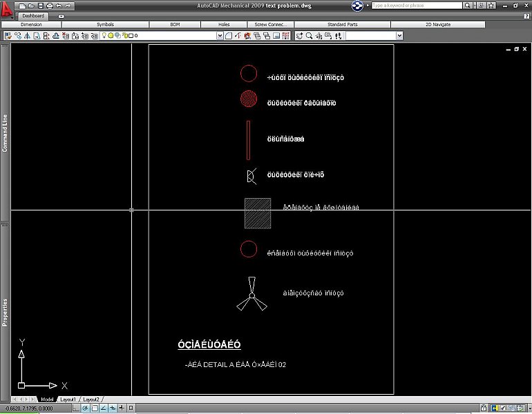

a client send this dwg and on my computer i can`t see the text,i`m using autocad 2008 i tried on other computer is working same the autocad 2008.the text is greek.where is the problem i attached a sample of text that is making me problems.

What do you mean you "can't see the text"? The text isn't there at all?
Or do you mean you can't read the text because it is Greek?
I opened the drawing in 2009 and I can see the Greek-style text.
I too can see text. Is it Greek? There seem to be a lot of vowels!

from where to take the font to resolve the problem ?what kind of font should i search......
I think that you need Bletchley Park rather than CADTutor.
My wild guess is that the letters have been formed from ASCII codes, but a constant has been added to the code numbers, which are all displaced from the required letters. Have you asked the source to translate them for you?
Resolve what problem? The fact that you can't read what's there?
Had a better idea, exploded the text, turned it into Mtext, copied it to Google to search, and this is what it came up with.
AÐÏÑÑÏÖÇÔÇÑÅÓ ÏÑÏÖÇÓ (translates to) ROOF MOUNTED CENTRIFUGAL FAN
You do not need Bletchley Park after all.
Brilliant idea eldon. Man, if I had a gold star I'd paste it to your forehead!:thumbsup:

thx very much, respect.
