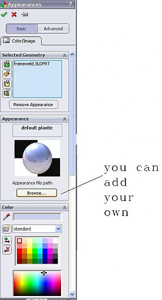

add a texture to solidworks?
hi
i'm making a model of a fighter jet
the built in textures are all fine if i wanna make something look metallic and what not
but i want to make the plane look like it is painted in camoflage something like this
freespace.virgin.net/john.dell/spitfireVJohnD2004.jpg
is there a way to insert your own textures to solidworks so u can make the model look like that?
thanks
(i am using solidworks 07)
When you are adding a material you can open up a preloaded material for its settings and apply a different map to it. Under the appearance hit the browse.
