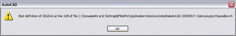

skipsophrenic Posted October 22, 2009 Posted October 22, 2009 Every timpe i try to load my linetypes I keep getting the folliwing error message, Have tried re-boout, no joy, any Ideas? Quote
ReMark Posted October 22, 2009 Posted October 22, 2009 AutoCAD doesn't like something about the particular linetype definition file. Did you do any recent customizing of ZIGZAG? BTW...a reboot will do nothing to fix a linetype definition problem. Quote
dbroada Posted October 22, 2009 Posted October 22, 2009 lin files are text files so open it with notepad and look at line 128. Does it follow the same format as all the lines around it? Sometimes it is as simple as a missing comma. If there appears to be an obvious difference modify the file in notepad, save it and open the drawing again. Quote
ReMark Posted October 22, 2009 Posted October 22, 2009 BTW...ZigZag is a standard AutoCAD linetype. Normally I wouldn't recommend tweaking it. I'd create a duplicate of it (call it ZigZag2 or MyZigZag) and tweak that instead. Bad line. Bad, bad, bad. Quote
NBC Posted October 22, 2009 Posted October 22, 2009 any chance you would copy and paste here the line definition for ZIGZAG from that lin file ? Quote

skipsophrenic Posted October 22, 2009 Author Posted October 22, 2009 The OOTB Zigzag linetype uses a shape defined in the ltypeshp.shx file. Make sure acad can find that file. Try typing (findfile "ltypeshp.shx") at the command line to see if the file is in acad's support path. finds it no problem here's what the command line returns. "C:\\Documents and Settings\\PSmith2\\Application Data\\Autodesk\\AutoCAD 2008\\R17.1\\enu\\support\\ltypeshp.shx" Quote
