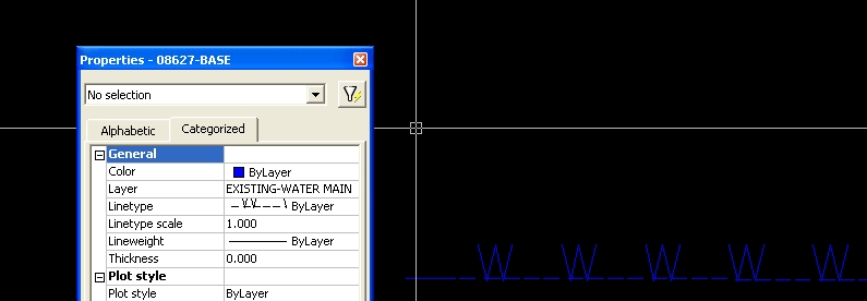

Has anyone seen and have a solution for the linetype problem I am having. I have attached a jpg. I did a print preview of my drawing and the linetypes that have text in the middle, i.e. water lines fences, etc... all have changed like the line pictured. Please let me know if there is a solution.
Thanks
Rah. This is something I've seen before; I dont' know if it's your problem necessarily, but what would happen is that some drawings' linetypes would randomly get out of whack. Letters within the linetypes would become extremely large or small (as shown on your jpg) seemingly without anyone changing anything like LTS or individual linescales, and it wasn't a Regen issue either.
When I'd go into the linetype editor (where you can create custom linetypes), everything seemed normal; the file was used by more than one drawing, yet there'd be an anomaly with no clear indication as to why this was happening.
What we ended up having to do was to change all the lines that had this linetype, Purge the drawing to clear that linetype, then re-import it either through copy/paste or through the design center from another drawing that had the same linetype. 99% of the time, this fixed it. It was a pretty easy fix as long as you have whatever's utilizing that linetype on layers specifically using them as well. -layiso and -ma become your best friends.
Hopefully, someone knows a better fix for this tech. aspect, but that's the solution I can offer.
Thanks Justin... I am thinking I may be the 1% here. I am having the same issue as what you describe. However, when I follow your direction and re-import through design center the linetype is still messed up.
Thanks for the suggestion, I wish it would have worked for me!
Find the textstyle used in the linetype definition. Set it's height to 0.0
That worked!!! Thank you so much! Have a great day!
