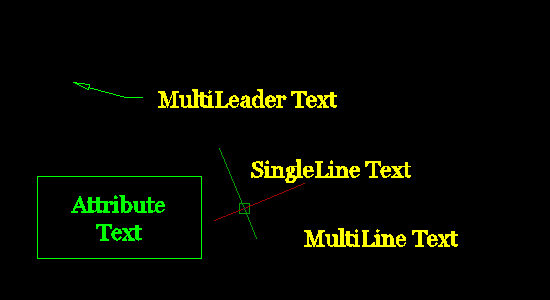

alanjt Posted October 23, 2009 Share Posted October 23, 2009 (edited) A request in another thread made me dig this up and do a little updating. I thought I'd post it for you good people. This will rotate all selected MText, Text, Multileaders and Blocks to match the current UCS (basically, rotates everything to zero). Updated: 05.31.11 ZeroRottaion.LSP Edited May 31, 2011 by alanjt Quote Link to comment Share on other sites More sharing options...

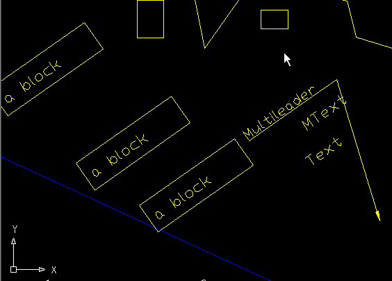

Lee Mac Posted May 27, 2011 Share Posted May 27, 2011 Alan, Nice idea for the program But be careful when the UCS plane is not the same as the WCS plane, since the UCSXDIR System Variable is expressed relative to the WCS plane. An example: The fix, change: (setq xdir (getvar "ucsxdir")) to: (setq xdir (trans (getvar "ucsxdir") 0 (trans '(0. 0. 1.) 1 0 t))) I would also be inclined to bound the UCS Angle to a variable prior to iterating through the SelectionSet to save recalculating the angle each time. Lee Quote Link to comment Share on other sites More sharing options...
alanjt Posted May 31, 2011 Author Share Posted May 31, 2011 Alan, Nice idea for the program But be careful when the UCS plane is not the same as the WCS plane, since the UCSXDIR System Variable is expressed relative to the WCS plane. Yes, I know and I know the fix, but if you had noticed, I hadn't updated this program since late 2009. However, since you pointed this out, I went ahead and gave it a complete overhaul. I even noticed that in April of last year, I had updated my AT:UCSAngle subroutine to work properly. Oh well, I never noticed, but it should be good to go now. Thanks for the nudge to update. Updated in first post. Quote Link to comment Share on other sites More sharing options...
