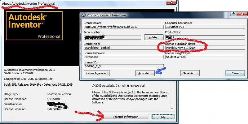

You can check the status of your license by going to Help>About...
If it shows unexpected date (should be 13 months from when you originally activated) then click on the Activate button.....
