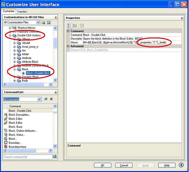

lpseifert Posted July 23, 2008 Posted July 23, 2008 In your CUI be sure the Dbl-click action for Blocks is set as shown (or similar). Also be sure Blockeditlock is off (0). Quote
GE13579 Posted July 23, 2008 Posted July 23, 2008 lpseifert- I don't know if it's a general Mechanical 2006 think, but I don't have that option... in my CUI it runs from "Keyboard Shortcuts" to "Mouse Buttons" Edit- Screen shot added below; Quote
lpseifert Posted July 23, 2008 Posted July 23, 2008 I guess 2006 doesn't have that option. Did you check Blockeditlock? (I can't be sure that command is in 2006). Quote

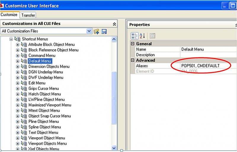

SPARKY77 Posted July 23, 2008 Posted July 23, 2008 In The Shortcut Menus Some One Hasn,t Changed The Pop Values Quote
