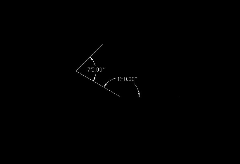

New2CADmike Posted October 27, 2009 Posted October 27, 2009 Hi All..I have been practicing using a older book(copyright 1990) and it has some decent exercises in it. I was able to do this one but it seems I can"t find the proper way to do this..First drawing a line a certain distance..ortho on,click the first point anywhere,move curser to the left and click again. that gives me a line at 180 degrees at what ever length..Line command again starting at the second point of the first line..after clicking that point,I type in @2.38 Quote
kencaz Posted October 27, 2009 Posted October 27, 2009 http://www.cadtutor.net/forum/showthread.php?t=40280&highlight=angle Quote
New2CADmike Posted October 27, 2009 Author Posted October 27, 2009 Thanks Kencaz..in that thread there is a post asking how to find that angle..in my drawing the third line angle is 45..adjusting the angle of the UCS -30 degrees make the line 75 degrees to the second line..doing the math as you explained..but in this exercise in this old book there is a series of lines drawn on the page all relative to the line previous..if each angle has to be made doing the math..lots of room for a error..I just thought ACAD had a 'relative to last line' type of command ..Mike Quote

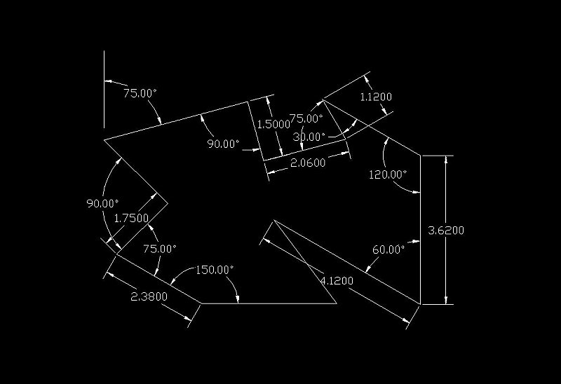

New2CADmike Posted October 27, 2009 Author Posted October 27, 2009 Here is the total exercise..I was able to do it,I just did alot of double checking to be sure it was right..Mike Quote
