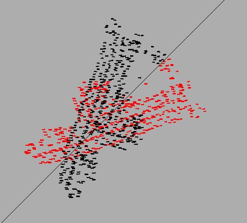

timurphy Posted October 27, 2009 Posted October 27, 2009 Hi im having a somewhat strange problem. Im running autocad 2004 and using total station to survey a building in plan. The data process from the survey appears to be fine but when i bring the points into cad the survey in mirrored/inverted but the two contral/station points are located in the right place. For example.. in survey terms im setting up at a stn located to the west and backsigthting to a stn at the east. i then carry out a survey to the south of these two points. However when the points are processed and bought into cad the stns are located in the right place but the survey is inverted and located to the north of the station.... any suggestions what might be causing this problem would be much appreciated. thanks tim Quote
lpseifert Posted October 27, 2009 Posted October 27, 2009 I'm guessing because your data is in a form similar to N,E,Z (or Y,X,Z) and Autocad reads data in the form X,Y,Z (or E,N,Z). Quote
alanjt Posted October 27, 2009 Posted October 27, 2009 Yeah, survey data is 'normally' collected in PNEZD format. What are you bring in the coords. with? Quote
Cadologist Posted October 27, 2009 Posted October 27, 2009 That would be my guess also, when you imported your points into C3D or however you did it, using a CSV file or whatever data of the points, ensure it follows the format, PNEZD not PENZD (or whatever your point data is recorded in, just confirm it's matching (CSV or point data to C3D input). That's the first thing I would check out. Quote
eldon Posted October 27, 2009 Posted October 27, 2009 Yeah, survey data is 'normally' collected in PNEZD format. What are you bring in the coords. with? Could you please show where in the world you are based, or qualify your statement, because in the UK, survey data is 'normally' collected in PENZD format. Quote

timurphy Posted October 28, 2009 Author Posted October 28, 2009 Hi-all thanks for f.eedback I don't think its the 'face left' problem and the horizontal angle appears to be correct. Im using a terminal programme to transfer the points from a topcon total station then pasting to notepad to create a csv followed by an excel file. im then using 'abc cad' add on that lets me bring the excel file straight into cad. this is when the problem of the mirrored points is presented. Strangely however if i call the x co-ord y and the y co-ord x when i bring the points into cad the survey is processed the right way round but in the wrong place and the wrong orientation. i just can't seem to identify the part of the process that is causing this problem, has anyone used abc cad before? Tim Quote
eldon Posted October 28, 2009 Posted October 28, 2009 If a survey is plotted with E and N in the wrong order, you will always get a plot that can be mirrored about a 45° line coming from 0,0. That is the maths of it. Quote
eldon Posted October 28, 2009 Posted October 28, 2009 Other things to check:- Were the Control Stations drawn in using the coordinates the correct way round? Were the Control Stations entered into the total station with the coordinates the correct way round? Was one Control Station picked up as a detail point from the other Control Station, and vice versa? Once you know exactly what has happened, the survey points can be recalculated if necessary. Quote
