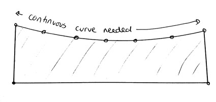

I'm new to Autocad, having come from a photoshop and Illustrator background, and not afraid to admit that it's quite a technical program!
I have a very basic grasp of what i need to do in 2d, but there is one aspect that eludes me through many searches and tutorials and I'm wondering if it is actually possible...
I need to create a progressive line that follows a continuously changing curve.. Imagine the cross section of the hull of a boat. The line is broken down into individual measurement points, but I need a way to smoothly join them all together to produce a constant curvature...
example of the line drawing I am trying to create attached..
any ideas?
kind regards :)
Look at the SPLINE command. You will select the points (7 in the example drawing), then select an initial tangent direction for the start and end. Or hint "enter" for the two tangent requests to accept a default values.

thanks, I have figured it all... so simple now I know!!!
