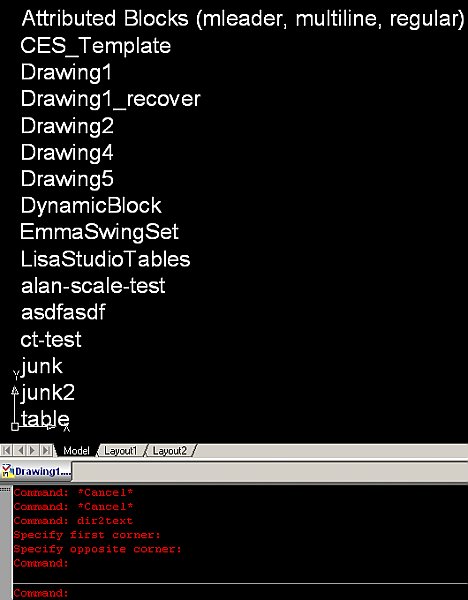

You'll have to excuse the directory list, I'm at home...
It will collect all dwg names located in directory of current drawing and place them in an MText object, based on picked location.
[ATTACH]15117[/ATTACH]
This was a 'to get you started'. Until you post an actual example of what you want, it's difficult to decipher your paragraph. A picture is worth a thousand words.

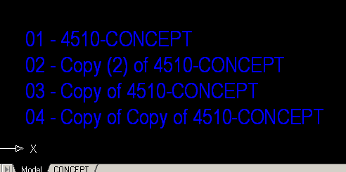

This is just turning into an exercise for fun...
I wanted to fix the 1-9 number to display as 01-09.
