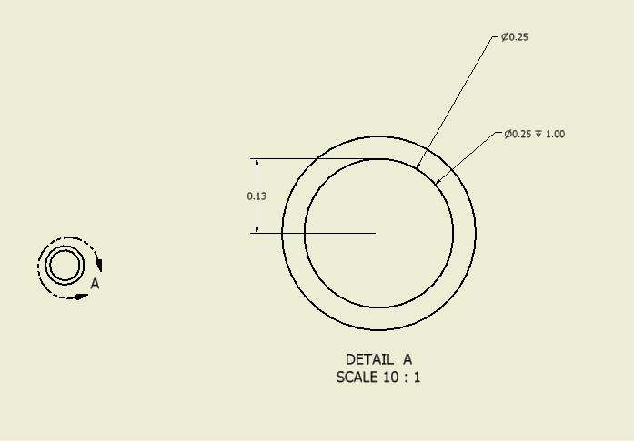

it should be no problem. Im sorry im not fully understanding. To me it sounds like you are getting a double arrow leader when you want a single arrow for the diameter?
I drew a small part, then made a detail view at 10:1. It lets me select the bore in the detailed view and dimension it. If the issue is the leader type you can change the standard type with Tools>application options>Drawing. Inventor is really good about giving you options during your selection. You may notice some icons pop up when you go to dimension the hole. If you click General Dimension its basically several different types of possible dimensions so your selection is important. Make sure not to select one of the quadrant points but select somewhere along the circle. the Icon will be a circle with a leader inside it rather than a Dot(probably green). If you select just part of the circle and drag the cursor you should get your dimension, but if you select the dot its looking for another selection to give a dimesnsion, so you probably selected the center of the circle.

Ah yes, the Linear Symmetric and Linear Diametric Dimension. In order to do this you need to have a centerline for the view which you can make with the Automated Centerlines command and then just turn off the centerline when you are done. Once you have the centerline simply create a General Dimension to it and then Right Click and choose Dimension Type Symmentric or Diametric depending on what you want.
Ill have to play around with it. Im not sure when you would want a reference line that goes to nothing though. When you add the dimensions in Inventor are you using the Hole dimension or general dimension?
edit, there you go:)
AWESOME! Worked. Now can i turn just the centerlines i want on and off?
click on them, then right click and turn off the visibility
