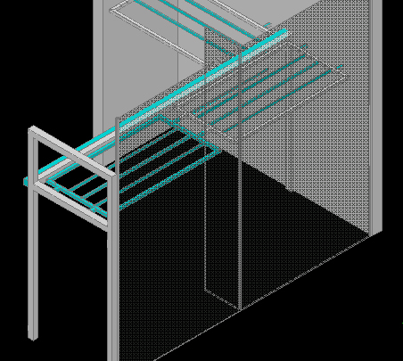

yedan Posted July 25, 2008 Posted July 25, 2008 if you have a transparent material then it will display transparent on the screen see attached, admitidly it doesn't show correctly i guess but it does illustrate transparent Quote
Cad64 Posted July 25, 2008 Posted July 25, 2008 I know that if you use a glass material, you can set the Opacity slider to see Transparency, but he's asking about opacity maps, I believe? And, as far as I know, you can't view those correctly in real time. They always display as a square map until you render. Quote
