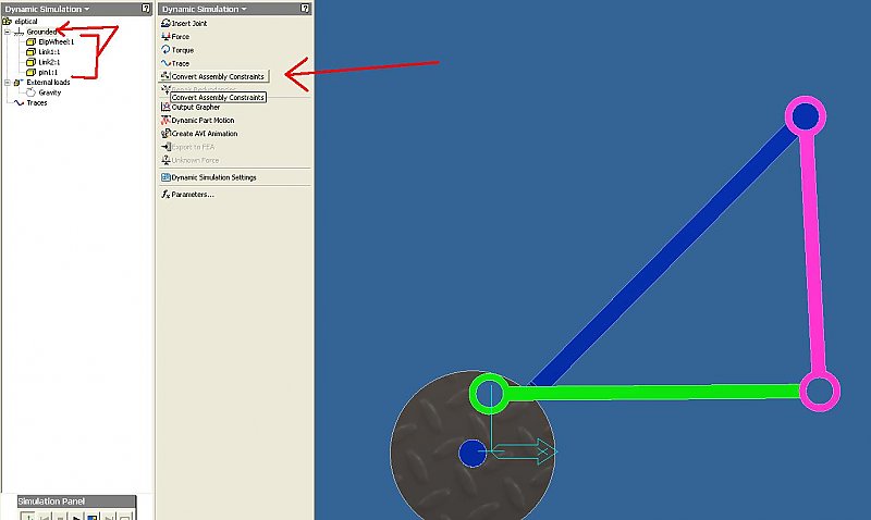

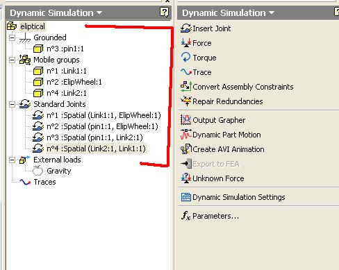

shift1313 Posted October 30, 2009 Posted October 30, 2009 Alright chris, i have an older version of inventor at work so i drew something real quick for you. I drew 4 parts. I have something that is the pivot point for both the "wheel" and for the upper link(which would be the handle). I have 4 constraints added to the assembly. All of them are "insert" constraints. This insert constraint will allow the parts to mate but still allow rotation. You can apply these mates to your parts and rotate them using the mouse in the assembly. In this case we are talking about simple mates, no real mechanical mates like interference or path driven stuff. So - insert constraint at the wheel center, the first link to the wheel, the links together, then the second link back to the base. In my case the base is just a blue piece that has two "studs" on it for the wheel and link to pivot. When you start the Dynamic simulation you will have a tree on the left side just like the assembly environment but this will have all your components, loads, joints etc. When you first start all components are grounded. This is because mates from the assembly arent automatically brought in. There is a Convernt Assembly Constraints button. This takes the constraints you already have and creates joints from them(if possible). This works fine for Insert Constraints. It will ask you to select two components and it will analyze the joint between them and show you what its going to create(if you check the box). In this case you should end up with 4 spatial joints, 3 components listed under the Mobile Group heading and your base(Pin1 in my case) will still be grounded.(see image 2) This should accurately(in this case) define the assembly. Now you just need to add force or torque. I added a small torque to the wheel. you need to watch your selection process on everything. It asks for a location and direction. i made a short .avi but i have to clear some space to host it. Quote

shift1313 Posted October 31, 2009 Posted October 31, 2009 Hey chris i took a look at your file this morning. one part didnt come in(a bolt) but thats fine, dont need it. Im assuming your "wheel" is rotating around the pin sticking out of the back of it and not the center right? The way the parts are oriented will make the leg loose contact with the track. The first thing i had to do was change one of your constraints. The two threaded holes that were for part 6 and part 1. I deleted their constraint and added an Insert constraint only. It looks like you had an insert constraint with the bolt but since that component didnt load it was unresolved. After that I created a nother part named Base that I could have the wheel pivot on. Its important to have grounded components(like your track was) to ensure certain geometry cant change in the assembly. Without some sort of structure the components have too many degrees of freedom and will not behave how you want. Just a note. Insert constraint not only locate two components concentrically but it will also mate with a certain offset. Part 6 had a mate, tangent and an insert. The mate constraint was not needed because the insert would take care of this. By selecting two circles(one on each part) you can model this without that bolt or any pins. This may be easier while you are trying to figure things out. One extra note from the pics/info i posted before. Inventor 2010 automatically analyzes and creates the joints based off assembly constraints. The older version i was working in doesnt and i forgot about this until just now. When you bring your assembly into Dynamic Simulation you will still need to create one joint which does not automatically get created. You will need a Sliding Joint - Cylinder on Plane. When you are creating this joint pay attention to the animation and selection process. First it asks you for a plane. Then an origin. If you look the origin is created but you can move it it you like. I selected the plane, then clicked on 2 to select the cylinder and then OK letting Inventor create my origin. The origins become extremely important but in this case the auto-created ones are good. When you apply a torque to your wheel, select the outter edge of your wheel first, then select the outter face. The value i used was very small. .005. Since there is no resistance, springs, friction and so in there is not much force needed. You could simulate the weight of a person by adding a foce on the link down. Hopefully i explained that enough to give you a start. Let me know if you have any questions. Quote

shift1313 Posted October 31, 2009 Posted October 31, 2009 sorry chris, the assembly file when i compress it is larger than the size limit here. I can walk you through step by step if you need, but everything is outline in the above post. Im not sure if i mentioned it but I did add one other mate. The side of the roller to the side of the track. Quote

shift1313 Posted November 2, 2009 Posted November 2, 2009 We are always here to help chris. I am by no means an expert with this stuff and there are other users in here that can help as well(although the inventor forum doesnt see as much activity as some of the others). I dont mind at all for you to send me a message or email if you like, but you may get more out of it just posting here. With this stuff there are usually many ways to approach the problem. While the info/method I gave you may work, another user may have another approach that may work better. Note on joints. When adding joints to your assemblies, a spatial joint is a catch all. It allows you to control each degree of freedom(6 of them). You will notice when placing the origin there are 3 axis, each with a different number of arrow heads. When dealing with two components, aligning the correct axis is important between the two. Say for instance you were creating a pneumatic cylinder and were trying to make the inner cylinder slide inside the body. Aligning the axis of both pieces and having only the degree of freedom along that axis will define this. I suggest you start with some simple parts before you get too deep in your design:) Its very easy to get in over your head with this stuff. And have fun Quote
