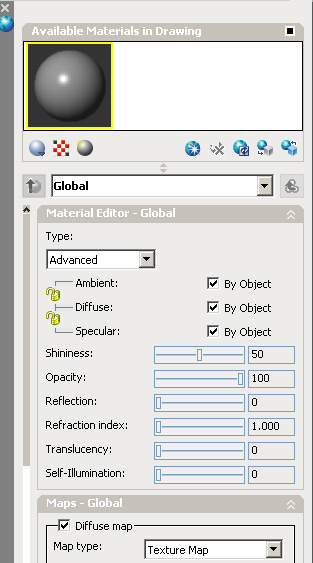

2nd, is my ductwork. It's glowing. haha, I don't want it to be really "glowing" put I want it to have a small amount of shine to it when I show the different colors for each system. And it's kinda mirroring. I just want shine, just a tad bit.

For your material reflection problem, I don't know what material "Type" you're using, but try switching to the Advanced material type. This will give you more control over your material and will allow you to adjust the Shinniness and the Reflection seperately.

Thanks for the help, I'll try the Material option and get back to you on my outcome.
