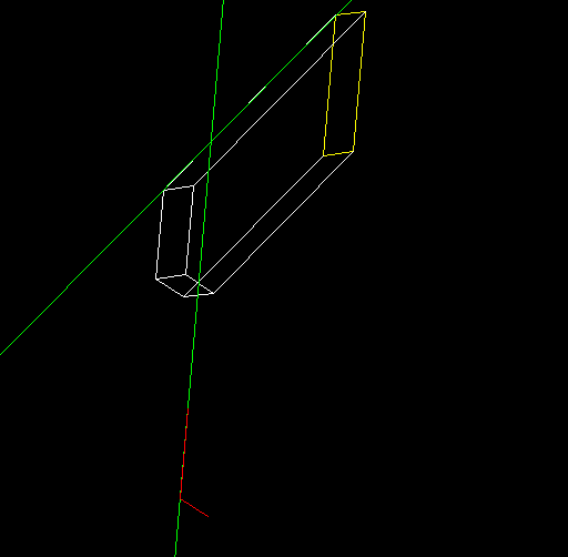

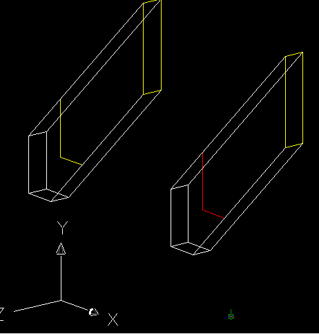

I can't get the snap's to work as I want them when trying to model in 3D. My main issue is with intersection and apparent intersection they don't seem to work with 3D objects. If you look at the attached file there are couple of 3D elements. The one has a yellow 'L', the other has a red 'L' just below it. What I want to do is to move the red 'L' vertically so that the top point of touches the the top of the 3D object i.e. as the yellow 'L' does. However it doesn't seem to matter what settings I use I can not get an intersection.

Intersection and apparent intersection do not work with solid objects as you discovered. An alternative (but somewhat cumbersome) is to use point filters - they take some getting used to.

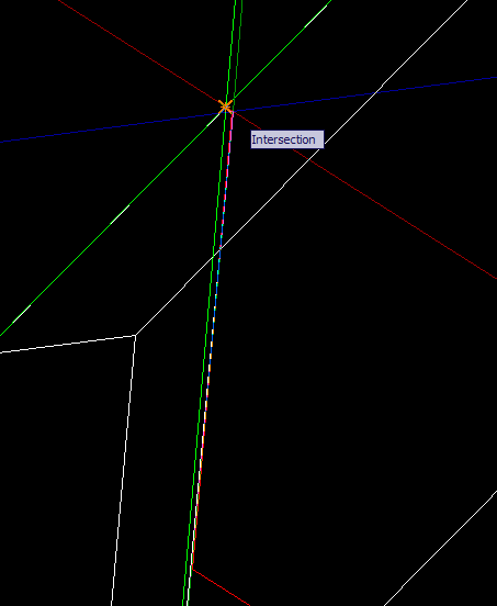

Working just in your left view I was able to create an intersection with a vertical xline and an xline following the top surface of your object.
Another option would be to move the L to the arrow head of the 3d solid and move it along the object using the endpoint of one side and an "extention" object snap tracker. Another option would be to align the ucs with that edge and move the L orthogonally along that axis til it's in place.
Above all, the easiest method would probably be to copy yellow L to the other object. Moving the Red L on top of the Yellow L, then deleting the yellow L.
Given the simplicity of the drawing, you could actually just copy the yellow L and turn it Red.

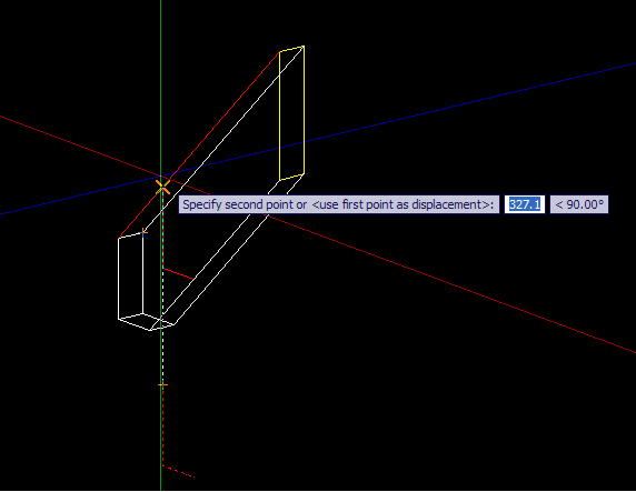

AutoCAD is finicky with the lines that make up a 3DSolid, as we've said. So I just made a new line (shown in red).
Using the Extension OSnap (not exactly necessary, i've just grown to love it), I moved the L up to the line I added.
The other option is to make a vertical XLine and an Xline along the edge it connects to. because the object starts on the same plane as that edge, they will actually intersect (this doesn't always work, but it does in this case).
That said, I just noticed your comment to ReMark about not wanting to use reference lines. To be honest, reference lines are easy. For one more answer, here's one that does require the Extension OSnap.
