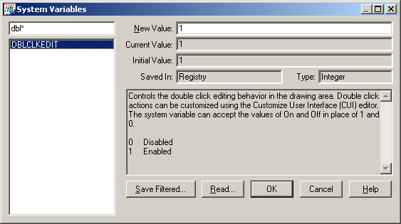

When I have a large block with lots of attributes I hold down the CTRL key and double click on an attribute on screen which allows me to edit it as single line text instead of going through the edit attribute box. This saves a lot of time.
This is not working on a colleague's machine who has exactly the same version of Autocad as me (autocad 2010). Is there an option or variable to change to allow this to work?
Thanks thats great - it was on 0 - also for some reason there was no double click command set in the cui box for "attribute"
No problem. :)
Autocad defaults aren't generally in the Double-Click menu in the CUI.
