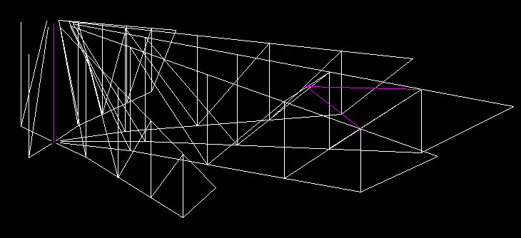

Hello every1, I'm new here, so hopefully this thread is in the right section.
This is what I'm looking for: how to make dimension for the slope. As what I'd attached, I just wanna put dimension on the 2 magenta colored lines (I dont know what to call it, so I just call it the slope). No matter how I put it, the dimension will only show the measurement flat on X-axis or Y-axis instead of the true length.
Dimensions (most all geometry) are always created on the current x-y plane. You need to adjust th UCS before creating the dimension. Remember to reset to WCS when done.
