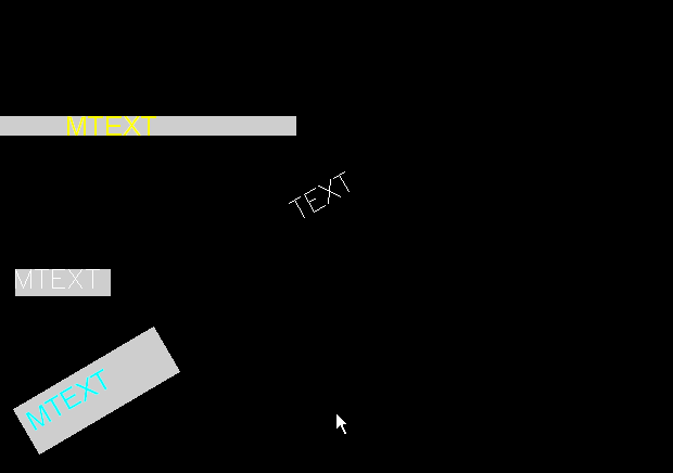

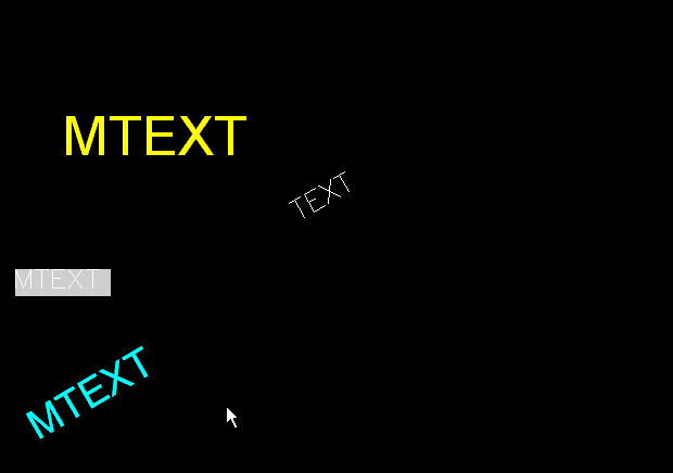

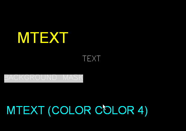

alanjt Posted November 4, 2009 Posted November 4, 2009 (edited) TextMatch will allow the user to select a source MText/Text object, then match the specified properties to all selected MText/Text objects. Properties available: "AttachmentPoint" "BackgroundFill" "Color" "Height" "Layer" "PlotStyleName" "Rotation" "ScaleFactor" "StyleName" "TextString" "Width" For now, I'm using the vla style names, but if it deems useful, I'll modify to be a little more user friendly. In regards to that AttachmentPoint = Justification. Call with: TextMatch or TM All comments are welcome and quite useful. Originally started here as a way to match text properties but ignore rotation. As you can see, I got a little carried away. TextMatch.LSP Edited October 12, 2010 by alanjt Quote

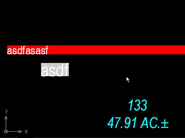

rfarah Posted December 8, 2009 Posted December 8, 2009 TextMatch will allow the user to select a source MText/Text object, then match the specified properties to all selected MText/Text objects. Properties available: "AttachmentPoint" "BackgroundFill" "Color" "Height" "Layer" "PlotStyleName" "Rotation" "ScaleFactor" "StyleName" "TextString" "Width" For now, I'm using the vla style names, but if it deems useful, I'll modify to be a little more user friendly. In regards to that AttachmentPoint = Justification. Call with: TextMatch or TM All comments are welcome and quite useful. [ATTACH]15304[/ATTACH] [ATTACH]15305[/ATTACH] [ATTACH]15306[/ATTACH] [ATTACH]15307[/ATTACH] Originally started here as a way to match text properties but ignore rotation. As you can see, I got a little carried away. it really nice, but is there a possibility to match Mtext height & width...because i have tried to match width but no action, if i match with Text it works...please advise. thanks Quote

alanjt Posted December 8, 2009 Author Posted December 8, 2009 it really nice, but is there a possibility to match Mtext height & width...because i have tried to match width but no action, if i match with Text it works...please advise.thanks Maybe I don't understand your request, but it will match height and width. Quote

alanjt Posted December 8, 2009 Author Posted December 8, 2009 OK, now I understand what you are asking for. Yeah, as Lee has shown, it's possible. However, messing with formatting codes in MText is a hairy area to play around in. Even Lee's code has a nasty trade off of losing all other formatting code and symbols will be replaced with a "?", within the MText object. I'm not interested in bugging up the code for one little missing ability. If you are really needing something like that, you are welcome to use Lee's, but even his has a few bugs (no offense to you Lee, I'm just stating the facts). Quote
