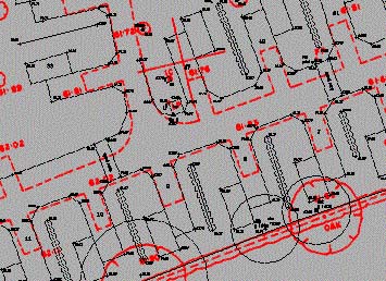

eldon Posted November 5, 2009 Posted November 5, 2009 If you get the image scanned and saved in TIFF format, then the image takes on the colour of the layer it is inserted to. Picture shows old survey in red, and I turned all other layers to black to show the difference. Quote
Nick-H- Posted November 5, 2009 Author Posted November 5, 2009 nice, thats what i want - just need to get it to scale once its scanned in Quote
