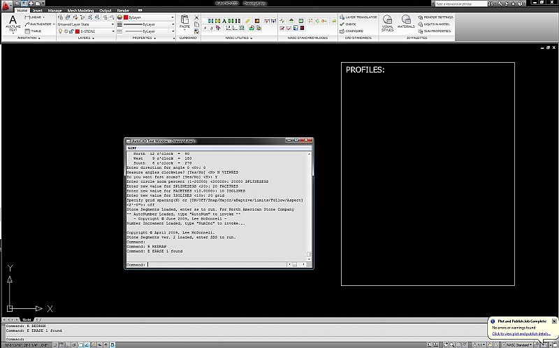

Oh, and, I actually had a question to ask. I actually want to get that acaddoc.lsp to not show up at the beginning of each drawing. I tried adding (command "MENUECHO" "2") to the beginning of the LISP, but it didnt work. Is there another way to accomplish this?
What do you mean by not show[ing] up?
Sorry, forgot to use proper terminology. The AutoCAD Text Window.
Sounds like you have (textscr) in your startup.
I explored that option a little bit at first. I was going to add a line (command "graphscr") at the begining of the run, but when the LISP runs, I get the following output (shortened):
Regenerating model.

AND the text screen still shows up.
I created the acad.lsp and acaddoc.lsp, and I haven't put (command "textscr"), or any other variation, in. Is there another file that would hold that value?
P.S. Here is the most current acaddoc.lsp
;;;North American Stone Drawing Set Up
;;;ENVIRONMENT
(command "base" "0,0,0")
(setvar "osmode" 6255)
(command "-INSERT" "Z_STD_SETUP" "0,0" "1" "" "0")
(command "ERASE" "L" "")
(command "-STYLE" "SHEET" "tahoma.TTF" "0" "1" "0" "N" "N")
(command "-LAYER" "S" "0-STONE" "")
(command "-DIMSTYLE" "R" "16")
(command "LTSCALE" "6")
(command "PDMODE" "3")
(command "PDSIZE" "0")
(command "-HATCH" "P" "AR-SAND" "0.25" "0" "")
(command "-UNITS" "4" "16" "1" "0" "0" "N")
(command "VIEWRES" "Y""20000")
(command "SPLINESEGS" "20")
(command "FACETRES" "10")
(command "ISOLINES" "20")
(command "grid" "off")
