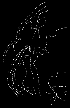

What kind of "3D drawing" are you thinking about? Points? a 3DPolyline?
Possible it can be achieved with a few clicks and copy/pasting the data in the command line
I created this inserting points at the coordinates. It took me about 5 minutes. The file needed some small adjustments, to have the x,y and z separed by commas instead of tabs. Using Find/replace in Notepad it did it automatically (Ctrl+H). After that copy the whole text in the clipboard (Ctrl+A, Ctrl+C)
In AutoCAD turn off the running Osnap (F3) and enter in the command line MULTIPLE(enter)POINT(enter)
Click in the command line and paste the data (Ctrl+V)

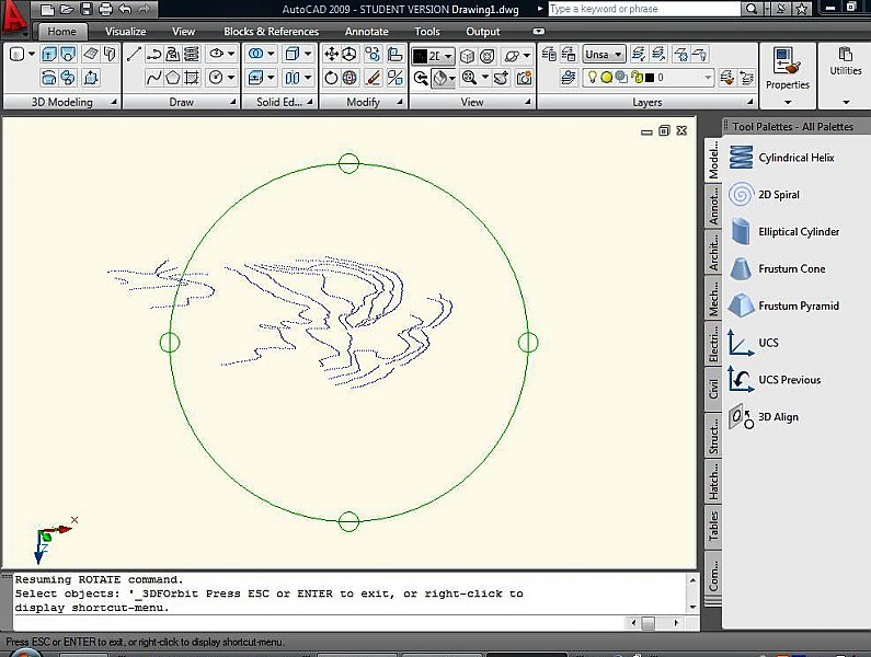

Dear fuccaro and shift,
Thnaks a lot.I tried it boath ways.Both are working very well.
I have one question.Can I see output as 3D view.I tried it using 3D orbit.It seems plat.
It is looking flat because it is nearly flat. The z values are much smaller compared to the x,y values. Try multiplying the z values by 10 before you import the data. :)
Yes eldon, you are correct.Thanks
