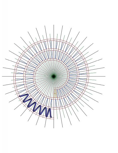

yb1 Posted August 12, 2008 Author Posted August 12, 2008 I made it, without LISP, by handycraft's way:shock:. 1. helix with 0 height 2. needed amount of rays (long black) 3. tracking the spiral by short straight polylines( go through intersections a spiral with rays (red line)) 4. offset red polyline on needed gap between cord (second red line) 5. making typical coil with 1 full turn at the begining of the spyral (orange lines) 6. array that coil, then draw another set of rays through midddle point of the coil(green short rays) 7. move every coil along green rays matching middle point of coil and intersection of the green ray with red polyline. 8. for second coil of the cord, repeat 6. and 7. 9. the funniest part: stretching coils till their ends touch long black rays. 10. using MOVE command, connect each coils, then explode them, then JOIN these spolilines in one. 11. extrude a circle by the path of coiled spline. and you get it. it takes about 1.5 hour. Quote
