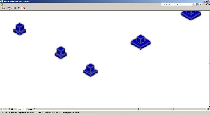

jameslrobert Posted November 17, 2009 Posted November 17, 2009 Hello, I have an issue that I really don't understand at all. I have been drawing a building using CAD 2008 but have been doing it in 3D. The first load of drawings I did worked just fine, in the layout's I was able to switch between having some showing in realistic or hidden and some ie the plan views in 2d wireframe and there were no issues at all. I have since started a couple of new projects since and have drawn them in 3D also however now even if I have every page setting the same as the previous drawing that worked the quality is so poor! Very pixelated! I really don't understand. If I copy everything from the model space into the old drawing that worked it works fine as well! So why isn't it working in it's own file? Is there a setting somewhere that I'm missing? I have attached a picture to show just how it looks when I do a print preview! Any help please because this is doing my head in!!! Quote

Glen Smith Posted November 19, 2009 Posted November 19, 2009 Sorry man, I don't know what the problem is - but if we assume for the moment that the two drawings have a system variable set differently, there is a LISP that you can download and run on the two drawings. The link is: http://www.cadalyst.com/management/news/tips-amp-tools-weekly-vol-12-no-6-7383 and the writeup for it is: System Variables Report Lloyd Beachy wrote SYSVAR.LSP to create a report of all system variables in a drawing and to compare system variables that are different between two or more drawings. The program creates a tab-delimited (*.TAB) file that you can open with Microsoft Excel or a similar spreadsheet application. NOTES FROM CADALYST TIP PATROL: Our Patroller agrees that this tip is helpful. He challenges Lloyd or another tipster to delve even further and program SysVar to take the TAB file and create a fix so the system variables are changed as needed. With this upgrade, the routine would be invaluable. Give this a shot and see if you can figure out which variables differ, from there, some time spent here or in the help file should nail down which ones need to be changed. Good luck - Glen Quote
jameslrobert Posted November 19, 2009 Author Posted November 19, 2009 hey thanks for that, I've run the program for both drawings and there aren't many differences. Most are dimension styles, text styles and to do with the view port sizes etc. There were a few differences however that could be the issue. Isolines in good one is 50 and in the bad drawing is 5 LUNITS and LUPREC differ also, though I wasn't sure if this meant anything. PSOLWIDTH various other variations were TDINDWG, TDUSRTIMER, UCSXDIR, VIEW CTR, VIEW DIR, VIEW SIZE, VS MAX & VS MIN. Any ideas? I'll have a play with the psolwidth and isolines, but otherwise I am still stumped. Thanks for your help though Quote
jameslrobert Posted November 19, 2009 Author Posted November 19, 2009 Nope I have changed everything to be the same and no difference, in fact the one that had previously shown up nicely is no longer doing so, I must have changed a setting on my CAD somewhere but I really don't know, this has totally got me, and it's really really annoying!! Quote
Glen Smith Posted November 19, 2009 Posted November 19, 2009 I don't do much in 3d so I am rather out of my depth, but the only other thing I can think of is Tools - Options - 3D Modeling and fiddle with the settings in there. Tessellation would appear to relate to what you are seeing, but like I said, I don't really know. Hopefully someone more versed in this will come along soon. Glen Quote

iskalipsi Posted November 23, 2009 Posted November 23, 2009 can u post another picture? try using a camera to view the objects Quote
jameslrobert Posted November 23, 2009 Author Posted November 23, 2009 hey here's a couple more pictures, these are from my page layout, using hidden in the vewports works. but not 3d hidden. and the 3D view i have selected the viewport as realistic and this is what happens! Quote

iskalipsi Posted November 24, 2009 Posted November 24, 2009 you have to create a camera first in the model view. after placing the camera, you can then switch to paper layout then double click on the inside of your title block then set the camera view as your viewport.then set the shade plot as conceptual. i have attached a file here. thats what i did. hope this helps:) layout.pdf Quote

jameslrobert Posted December 2, 2009 Author Posted December 2, 2009 i've tried this now, doesn't work sorry guys. there really isn't anything i can find to solve this problem....doesn't anyone know how to up the image quality in my layout when i have realistic on? surely someone must know! Quote
iskalipsi Posted December 2, 2009 Posted December 2, 2009 have you already placed a camera in your drawing? if so,switch to paper layout then after double clicking in your view port click on to the camera, right click then pick "set camera view" from there.. tell me if this helps. Quote
jameslrobert Posted December 2, 2009 Author Posted December 2, 2009 no i'm afraid that the quality is still just as bad in this view. it has to be a setting somewhere that i just don't know about. i'm totally lost, and fairly annoyed about the fact that i have to just show everything i've drawn in 3d using only the basic hidden style!! Quote
