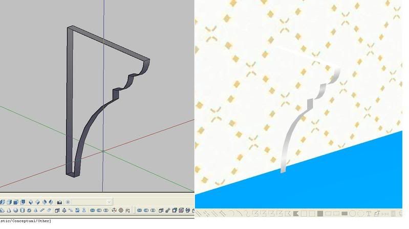

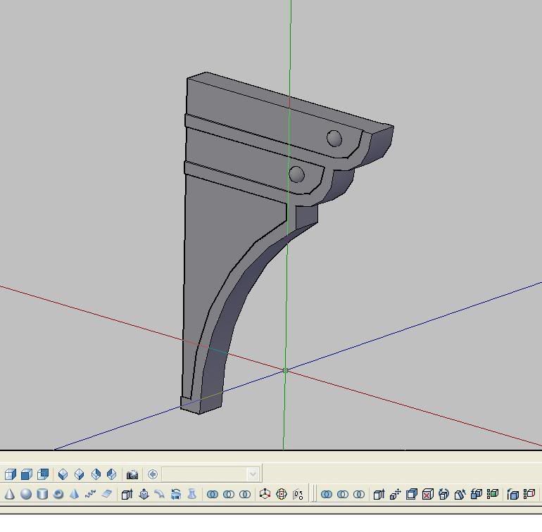

kellenhaskell Posted August 26, 2008 Author Posted August 26, 2008 FINALLY i feel like ive made some progress. So i looked at the dxf files for the 3d objects already in cabnetware trying to see what the difference is between theres and mine. I noticed that the 3d objects they had were actually "Polyface Mesh's". So i took my old drawing and tossed it. I redrew the outline of the corble with a Polyline than used the TABSURF command to make it 1" thick. I Saved it as a .dxf, moved it to the right folder, and imported it into cabnetware without a problem. Well except for one. When i used TABSURF all it did was make a 3D outline of my corble (ill attach pics to explain) I need a full object with all faces on it. I guess my question now is if anyone has experience making 3d MESH objects rather than just extruding and subtracting. I've never modeled with Mesh so its a bit overwhelming right now. So if someone could help me out on how to get my 3d mesh object now to look like my old 3d object What i have right now (3d mesh using TABSURF)(left is autocad right is cabnetware) my old corble that i made using extrude subtract etc... Quote

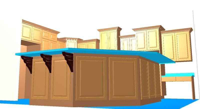

kellenhaskell Posted August 26, 2008 Author Posted August 26, 2008 Oh baby i got it haha so i found this program on the internet that is specfic to convert solids into meshs, Just downloaded it, paid for it, and let it do its thing. Converted the old corble i drew and worked perfect!! THANK YOU for the help and hopefully the dirty work ive done will maybe help someone else out too! Heres an idea of what i was doing and in color (the render texture needs to be played with...i just selected a dark cherry to see if it worked) Now i can finally start drawing in all our custom hoods, corbles . . etc Quote
