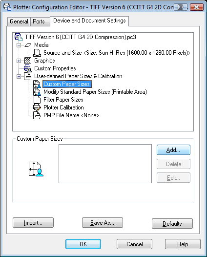

I did the plottermanager command and set up the Print to Tiff option. Tried it, but how am I supposed to print to certain size sheets at scale if it only prints in pixels?

Easy, after you create the *.pc3 file just double click it, and go to the "Device and Document Settings" tab, User-defined paper sizes & calibration -> Custom Paper Sizes and add in the pages you need. Just remember to put .01 on the scale in the Plot Dialog Box when you "Plot to TIFF" since the resolution of a TIFF is 100dpi or something like that. :)

Interesting that you mention it. The driver says it creates the raster image at 100dpi, which would mean you would need a 3400x2200 raster image to fit a 34"x22" sheet.
However, when I plotted one at this size and opened the TIF in a image editing program, it said the print size was ±47.2"x30.6", which translates to 72dpi.
So based on that, I set my sheet size to 2448x1584, and I ended up with a print size of 34"x22". Of course 72dpi is not very good quality compared to what many printers can produce.

But yeah I had to set the res to 3600x2400 for a 36"x24" scaled TIFF plot, you are correct and I failed to mention that part when Adding the custom sheets.
