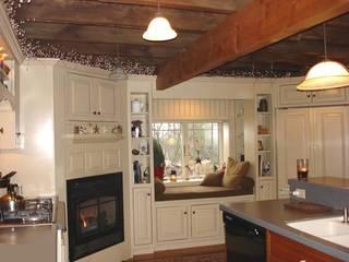

Tankman Posted November 24, 2009 Posted November 24, 2009 And, where is Brooklyn? Sounds very familiar. Do they use presure treated wood in Brooklyn? I used a lot of Douglas fir in my house (er I mean barn). Heavy stuff, 3 1/2" x 11" (actual measurement) stringers and stairs going up 35 ft to the two high lofts. Original basement beams are 12" x 12", hand hewn, circa 1894. Outside walls 18" thick stone. Quote
