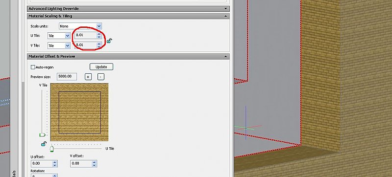

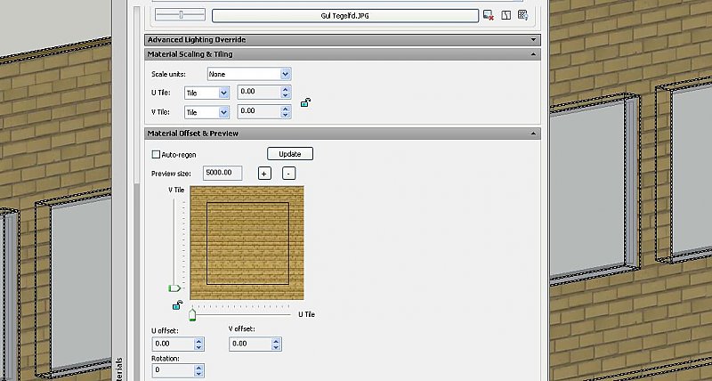

I´ve done some materials of my own but I get this problem when trying to scale them:
When i set V tile and U tile values to "0" the picture/material is too big, I would like to have it about 1/4 of the size.
But when I do Make the smallest move there is on the scale, "0.01" it get way to small! and if I set it to lets say 0.05 it it so small one couldn´t even see it!
Any suggestions?
It does not help if I edit the pictures size up or down. The dispay is the same.

Now this is my problem, maybe i described it bad since my english is quite poor :P
I need the bricks so be smaller than in the first picture, but a lot bigger than in the latter one!
And if I choose any other scale unit than "None" it gets so smudged out you cant tell what it is.
I've been having this problem for hours now :S please help!
