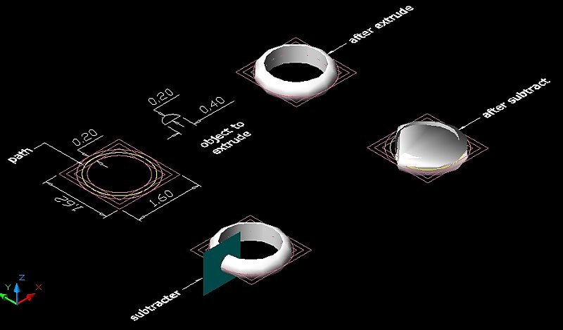

I need to make a half round chain for necklace, the link size is 1.60 X 1.62 and the half round wire is 0.40 X 0.20. Each links must have gap 0.0001 (link mouth).
So I use a half round (size 0.40 X 0.20) as object to extrude along an ellipse path (size 1.20 X 1.22), then subtract with a plate (size 1.00 x 0.0001)
The problem is, I have a strange shape after subtracting the half round link with the plate. Any idea what is it caused by?:?

hello to you too,
i opened your .dwg and its seems pretty normal to my pc. Have you checked other visual styles?
or maybe some redraw/regen?
yes, I have it checked in wire frame and do some redraw/regen, but it's still strange.
Hi changelo3D!
I opened my dwg at my colleague computer (he is using mechanical dekstop 2006) it also looks strange. For information I drew it using autocad 2004, cause i more familiar with autocad 2004 than 2008.
But when I opened it in autocad 2008 it looks normal. The question is, why only ellipse path (circle, pline, line path...etc - no problem) has the problem?
