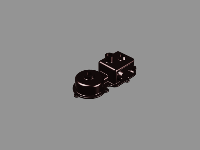

Drew the external thread and then subtracted it from an enclosing box - seems to work OK.
Drawing a gearbox cover (attached png - six threaded holes about base - sorry about the quality - very new to rendering and lighting and haven't figured it out as yet).
I've just seen a previous thread about a follow up question I was going to ask - is there any point in drawing the internal threads - they didn't seem to come to a consnsus.
I don't see the point of drawing internal threads unless the drawing has to be highly detailed for a reason. But then again most threaded holes in our drawings have a bolt in them anyway.
