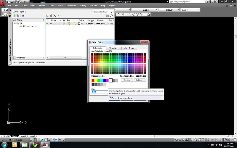

scoo9 Posted November 27, 2009 Posted November 27, 2009 no too sure about 3D but in autocad 2d drawing you can't use the number 255 for white. you must use the word "white". otherwise it will plot white on white on paper and you see nothing. Quote

scoo9 Posted November 27, 2009 Posted November 27, 2009 try this. this menu is in Layers. click on the layer showing white and a box appears to select a color. go all the way to the bottom and type in "white" and click OK. attached is a file showing this screen hope this helps Quote
