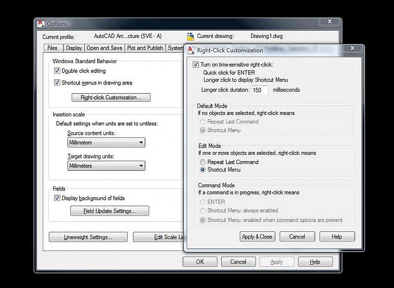

Under Right-Click customization, is "Turn on time-sensitive right-click"
ticked or not (on or off)
If on, hold right click button and your shortcut menu appears after the amount of milliseconds you type in. Quick click=ENTER
Hopefully this helps you!
//Tobias
