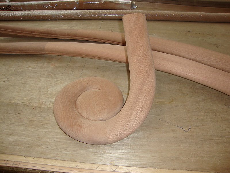

Arnie Posted November 28, 2009 Posted November 28, 2009 Hi guys . I was wondering if anyone would be able to help me out with this wreath ( shank ) handrail. I have tried with extrude, sweep and loft but just can't make it to work . Thanks Quote

CarlB Posted November 30, 2009 Posted November 30, 2009 That shape reminds me of a "logarithmic spiral". http://mathworld.wolfram.com/LogarithmicSpiral.html Spiral transitions to a straight section. My clumsy attempt would be to have 3 curves to define the edges & center of the fairly constant width part; then a disc for the center. Extrude a rectangle for the arm, join it to the disc for the basic shape, like a lump of clay. Then create shape that will be extruded along the edge curves, to be used to "subtract" to round the edges. Quote

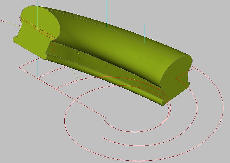

Arnie Posted December 1, 2009 Author Posted December 1, 2009 Thanks guys. Will have a go at it again tomorrow in both Rhino and CAd ... The only thing with cad is that can't quite get the extrusion to run its path and keep the bottom part from twisting ... any ideas? Obviously I played with the angles which makes it a little better , however its not quite right is it ? how can I prevent it from happening ? Quote
iskalipsi Posted December 2, 2009 Posted December 2, 2009 try using the sweep command then from the sweep path, pick base point.or i might be wrong. can you post a picture so we can see whats wrong? thanks Quote
Arnie Posted December 3, 2009 Author Posted December 3, 2009 Hi guys. That's how far i got .I found that if I extrude the whole lenght of this scroll from the start point ( curly center ) I just can't get the bottom of the handrail to stay parallel to its base ( prevent it from twisting along the path ) . Is there a way to get over it ? Thanks for you all again. One more thing . how can I measure the angle between the center of the scroll and end of it ? Quote
