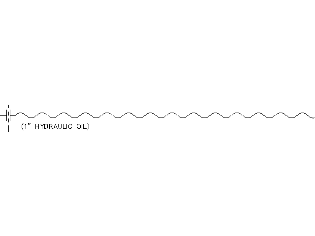

naknakkus Posted December 2, 2009 Posted December 2, 2009 I've seen LISP routines that achieve this, but I can't use them in LT. Is there a way to create a linetype that would allowed me to draw a flexible hose? Quote
lpseifert Posted December 2, 2009 Posted December 2, 2009 This is by CAB I believe *N12,Corrugated Pipe 000000000000000000000000 A,0,-.000403,["U",Standard,y=-.052104,s=.05],-.033333,["U",Standard,y=.047896,s=.05,r=180],-.000382 Works pretty well if the text style "Standard" uses the txt.shx font with a height of 0. You'll need to play with Celtscale to get the right size. Quote
naknakkus Posted December 2, 2009 Author Posted December 2, 2009 Thanks. I tried that out, but it isn't exactly what I want. I've been drawing the lines with arcs, though, so at least I have a way to do it, albeit slowly. It works, but corners are tricky! Here's a screenshot of what I'm trying to do: Quote
lpseifert Posted December 2, 2009 Posted December 2, 2009 You could... make a shape of a 'squiggle' and include it in a linetype definition. use the tilde ~ as part of the linetype definition. make a block of the 'squiggle', draw the flexible hose with a polyline, use measure to 'array' the block along the pline, erase the pline. Quote

naknakkus Posted December 4, 2009 Author Posted December 4, 2009 Bummer. It's strange that squiggly linetypes like that aren't bundled with the program. I've done quite a few drawings that needed them. Anyway, I managed to draw the stuff manually. Thanks for your responses. Quote
