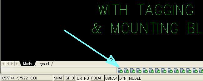

I know I've removed them on the last installation but I've forgotten how....
How do you get rid of this notification? Its beginning to cover up the stuff I do want shown (or was until I moved it).

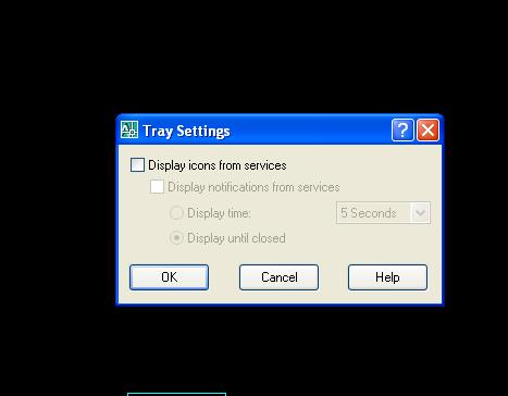

I've looked on other AutoCAD sites and it does sound like its related to SDI mode. I have got rid of it in the past on my previous installation but I can't find the "turn this annoying feature off" button on my new one.
yeah!!!! got rid of it!!!
I don't know (and no longer care) what else I may have turned off but unchecking this box has me a nice clean screen.
