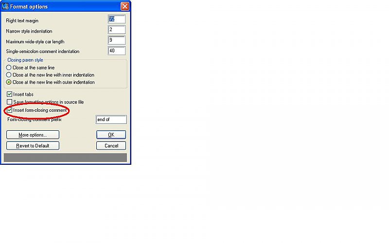

lpseifert Posted December 2, 2009 Posted December 2, 2009 Actually it will add the comment if you want Tools>Environment options>Visual Lisp Format Options in this case it would read ;_ end of setq... that can be edited also Quote
