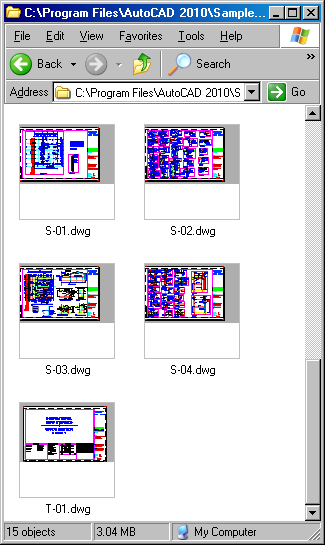

rkmcswain Posted December 2, 2009 Posted December 2, 2009 It's built into Windows XP and later. Quote

rkmcswain Posted December 2, 2009 Posted December 2, 2009 Did you try it on the same directory as shown? If the drawings are older or do not have a preview embedded for some other reason, then the preview will not show, no matter what you use. Quote
