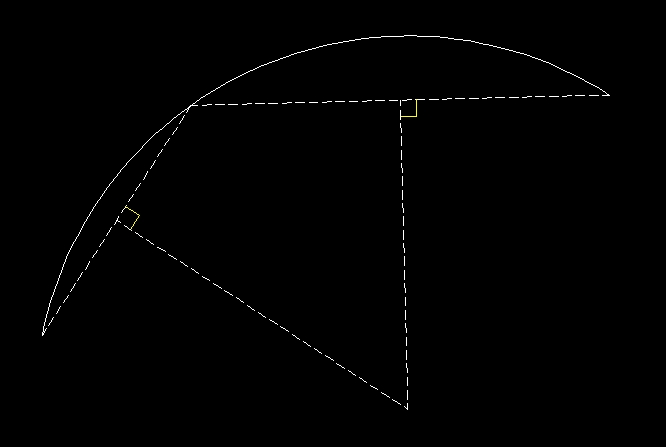

It sounds like a reverse engineering effort on a drawing that may not have had all the dimensions listed.
If so, then one general method would be to send out a perpendicular from two separate chord midpoints. The intersection would be the arc center. Measure from there to an arc endpoint for a radius.

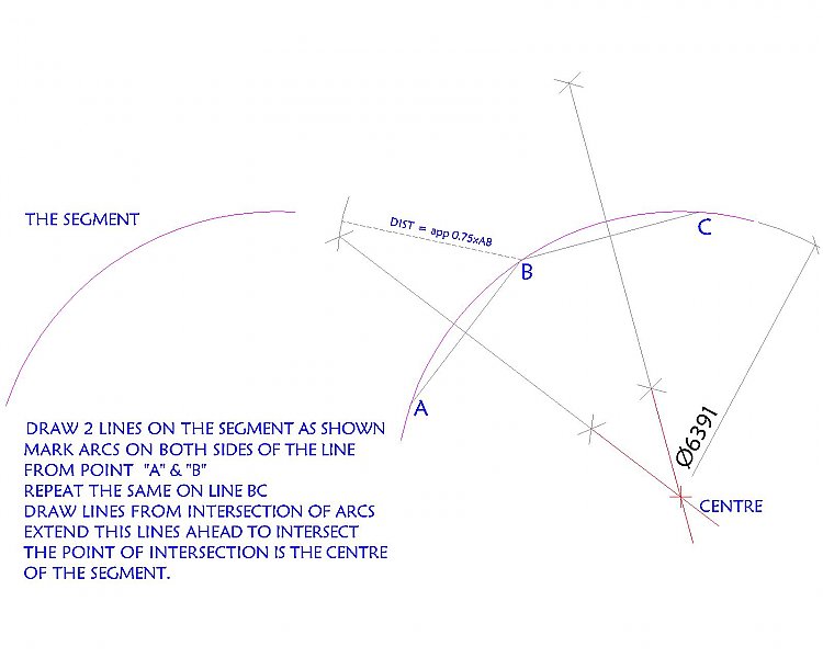

I hope this would clear your doubts
