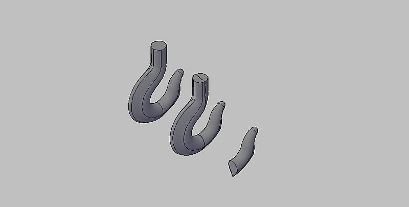

I have been working on lofting a crane hook for my "Autocad-Beyond the basics" class. I finnaly got it looking like I want it to look, or mostly anyway, I have 2 pieces that I want to union together after having sliced them apart. But when I try to union two parts that have just been sliced apart I get an error message: "Null solid created - deleted" and the parts get deleted.

The hook in the back is a copy of what was sliced to create the hook in the middle that has been sliced into 3 parts. The portion in the front is a copy of the sliced off tip. When I attempt to union any 2 portions of the middle hook I get this error.
Can anybody explain to me why I can't union these parts?
My instructor suggested taking the tip and subtracting it from the whole, and that also causes the error message.
What am I doing wrong?

i have no idea whats wrong if those solids are from the original one, only sliced.can you upload the cad file? i'll see what can i do. thanks
The file is too big, address request sent via PM.
