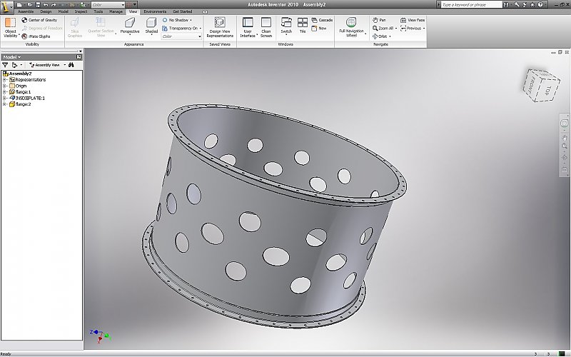

I have created this 3d model in inventor 2010, and i need to get the inside face of the model to be laid out flat, so i can dimension it so the shop guys have an easier time making it..
Any ideas how i could do that?
I have created this 3d model ...
Did you intend to attach it here? Sounds like you are afer a flat pattern... but without an image or file....
Oh yeah.. Ive got a pic..
Im trying to "extract" the inside face.
Everytime i try to select any tools in the sheet metal ribbon, i get a "no unconsumed sketch on the part" error, and the entire modify tab is greyed out. I created this part as a regular IAM, then converted it to a sheet metal part, this may be part of the problem
Have you but in a split line? it will not go flat if it cannot open out.
